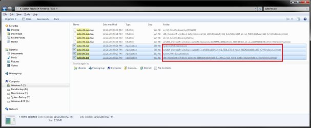

Hello,
I've followed the instructions posted here a few times without success.
I was wondering if you could take a look at the log attached.
I've attempted to replace both the main and stored locations at separate times:
C:\windows\SysWOW64\autochk.exe
C:\windows\winsxs\amd64_microsoft-windows-autochk_31bf3856ad364e35_6.1.7601.17514_none_4019f2b8d860ad30\autochk.exe
Am I missing something or do you think I should just run a repair install?
Thanks ahead of time :D
Windows 7 Premium SP 1 64-bit
Hello Wireman, and welcome to Seven Forums.
The screenshot below shows all 4 different locations that this file is located. You might see if replacing the file from and to the same locations from either your installation disc or another computer may help. You'll notice the the size of the file is different.
I've been trying to fix that error for 3 months and you nailed it.
It turns out that the winsxs 32-bit autochk (size 653Kb in the photo) was the problem.
Thank you Brink
That's great news. You're most welcome. I'm not sure why they would be different either, but I suppose they have their reason. :)
