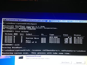

Hi everyone,
When I run sfc /scannow I get to see "this process will take some time." and a blinking cursor whereupon absolutely nothing happens; this screen stays on forever.
My Lenovo Y500 won't boot into win7 anymore all of a sudden and after puzzling around for several hours now I'm close to despair. The laptop freezes at the windows logo screen, so pretty much at the beginning of booting. Laptop won't boot into safe mode, BIOS reset didn't work out, only working option is "repair your computer" from where I'm able to run command prompt. However sfc /scannow seems to freeze / go on forever. I have a Lenovo Y500 with 1TB HDD & 256 GB SSD (system) installed. When I run CHKDSK on the SSD it also freezes in stage 2 at 16%; no error warning, the screen just stays on forever. When I boot from a rescue disk however I'm able to access all the files on the SSD without any errors.
I've added a picture of the sfc /scannow process where I'm stuck.

Maybe it's hard to read in the picture, but I entered the following:
sfc /scannow /offbootdir=c:\ /offwindir=e:\windows
Is this correct?

No - both instances need to be either D: or E:

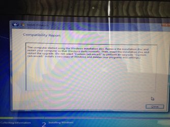

Oh thanks. Tried it with /offbootdir=e:\ /offwindir=e:\windows this time. Still no progress, its running now quite some time.
Furthermore a repair install doesn't work since you have to run the installer from within windows, which i cannot access.

Did the SFC scan actually start, though? It can take 20minutes or so to complete.
If not, try the D: drive instead.

It seems like it didnt even start. D: isnt my system drive, nevertheless I also tried it. I included a picture of my screen. This text stays on forever and my pc doesnt get passed it. Command Prompt doesnt respond anymore from this point on, i cant even enter "exit".
