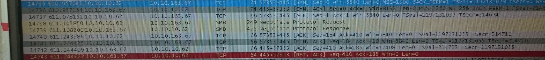

Here is what the capture looks like.. the 10.10.10.62 is the print server..
it just keep repeating this sequence.. I think something has to do with the TCP RST, but the PC is listening on SMB port and I tried accessing the printer from a windows machine and I had no problems

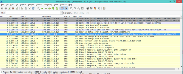

Here is a capture of what happens,
A connection is opened.. SMB negotiated but doesn't go anywhere aferwards.. connection is closed..
