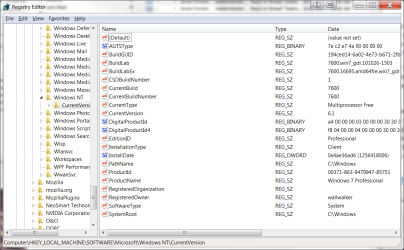

The winlogon key is very much there. Make sure you're looking in the right place.
HKEY_LOCAL_MACHINE\SOFTWARE\Microsoft\Windows NT\CurrentVersion\Winlogon
Too many to describe...
Yes? Show me where:

You need to click on the little triangle at the left of "Current version" in the left pane, that'll expand that key. Then just scroll down to winlogon.
