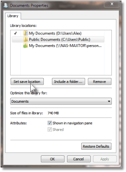

Here's a screenshot:
This screenshot shows how a Tortoise SVN checked out folder is correctly displayed with its overaly icon in the XP Mode Explorer window. Right-clicking this provides the correct Tortoise SVN operations and these work properly as XP-Mode instances (whether or not Tortoise SVN is installed under Windows 7 itself).
