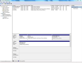

see comments underlined:
My 1T internal hard drive has nothing but Windows on the C: partition, and an HP Recovery image on the D: partition.
You probably ought to post a screen shot of Windows Disk Management as a precaution, as I suspect you have more than 2 partitions. I'd like to know how much space is occupied on C anyway.
Looks like you are correct, there is another partition called SYSTEM. The C: partition is not very full, besides the operating system it does have a few downloads I've been collecting and need to move off before I clean reinstall. Can you explain why the D: partition is grayed-out?

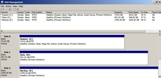

I've never owned an external drive and don't know if you intend to break open one of your externals and mount the drive internally---or buy an internal. I don't know if all externals can be easily mounted internally. You can buy a 1 TB internal for $60.
Or is that "My Passport" an internal? If it is, you are set to go. Do a clean install to a C of maybe 150 GB on Disk 0. Make a D of the entire remainder of Disk 0 for original copies of data. Use My Passport for backup of D. Use externals any way you want for additional backup. Get rid of the HP Recovery D.
Here's my Windows Disk Management. 3 drives, all internal, all with a single partition. C is an SSD. D is a 1 TB primary data drive. E contains two backups of D. I also back up D to another internal mounted in an external dock. And also back up my most critical data files to a USB stick. I do my primary backup of D to E once or twice a day. The other backups are monthly or so, on a rotating basis.
I make images of C, store them on D, and back them up to E. The only images I make are of the C drive. All other backups are just file by file, as if you'd used the mouse to copy.
