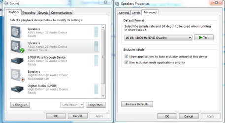

If low sound volume is the only problem then also try doing this, set to DVD quality 48000Hz.

Thanks a ton the drivers above worked and gave me the higher sound output I had in xp! YOU ROCK!!!
