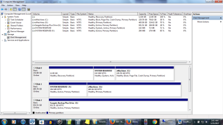

After you transfer the OS using Paragon, did you go to Disk Management and assign it a Drive Letter?
This is for Windows 10, but it is exactly the same with Windows 7.

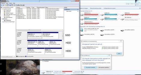

Thanks for your help, but Windows 7 automatically assigned it a drive letter:
Strange thing is, my PC recognizes the SSD, sees the windows partition, but it's numbered "N", and my old HDD windows partition is still "C". I can't manually change that in windows.
I wanted to change C:\ to "Q:\", then change "N:\" (the SSD) to C:\, and then Q back to N again, switching them around, but win7 won't let me.

If you boot from the SSD, the OS partition will be automatically the C partition. You are apparently not booting from the SSD. Are you sure you have set the SSD as #1 in the BIOS boot order.
Yes, I'm sure. My BIOS (which is quite a modern looking BIOS from my ASRock 970 Extreme4) has a line that lets you set priority for all your disks, so I set the SSD as first, then the HDD's, and another line that sets boots priority, where you can select between disks/DVD/USB. I set disks as first boot device, and it shows the SSD priority.
I'll see if I can take some pics tonight at home.
The one time I managed to boot from the SSD, I got that "bootmgr missing" message, so I guess my BIOS skips the SSD and takes the next in line: the HDD with windows.

When you are booted into your old Operating System, it does not matter what drive Letter your SSD has. When Windows boots into the SSD, it will become C by default. Paragon names the target drive the same name as the source drive, and every time I have done it, does not give the target drive a drive letter.
If you noticed in the video, the new drive was given the drive letter R. When it rebooted into the new disk, it was listed as C. Whatever drive Windows boots into is designated as Drive C. After finishing with Paragon, the new drive is also given the exact same name as the source Disk, that's why it was renamed in the video, so we could tell which disk we were booted into.

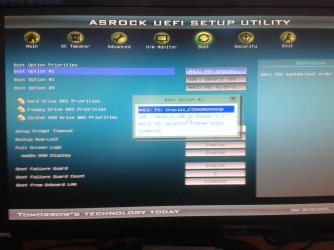

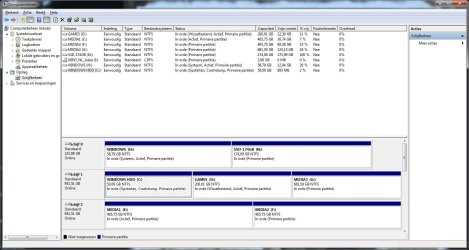

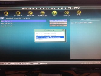

Here are some pictures.

That link helped. I only had to set the new SSD partition to ACTIVE, reboot with the DVD, repair the installation (which apparently both windows partitions needed, the HDD one and the new SSD image), then I rebooted again, I got a BLACK screen with the choice of TWO identical names to boot (both were called "Windows 7" something, but I could not discern which one was the HDD and which the SSD partition, so I tried the first, it was the HDD. I should have taken a picture. Rebooted, go the black choice screen again, tried the second, and Eureka! SSD booted. SO FAST! I am so glad I bought that SSD now.
Some screens:
first one showing the OLD situation after I tried option 1.
second with option 2, and the SSD being renamed to C:, after reboot with some drivers being installed.
Thank you all!
PS: I think greg's post should be included into the OP somehow as a troubleshooter should things not work right off the bat, as was the case with me ;)

Glad that worked for you. Having the new Win7 partition marked System means it is booting itself. However it is not marked Active now so Mark Partition Active
What I notice from the screenshots is that several data partitions are wrongly marked Active when only the OS partition should be. So mark the two wrongly Active data partitions Inactive: Partition - Mark as Inactive - Windows 7 Forums
Are you keeping the SSD Win7 partition small to include only the OS and programs, intending to link your User folders to the other partition there that's now empty? If so be aware that you can move the User folders to a slower HD because they benefit least from the SSD speed. Doing this makes the backup image smaller so that if Win7 ever becomes irreparably you can reimage C in 20 minutes while the data is safe and current in its own partition that's still linked to the OS. User Folders - Change Default Location
More of what works best is all here in Clean Reinstall Windows 7
It's really easier to manage data partitions when you do it with folders on one large partition rather than a bunch of smaller partitions that can quickly become too small.
I wouldn't partition your SSD to have an OS partition much less than 100GB. You don't know what new installed programs you may want. At this stage it is easy to extend this OS partition a little. Too large an OS partition and you have undesirable large system images as mention in the previous post.
It looks like you may be booting through one on your HDDs so I would disconnect all drives except the SSD and confirm that you can boot. If not then you have some more work to do.
The partition is actually active, you just can't see it in the second screenshot ;)
Thanks, I'll do that!
Yes, all my documents, music, pictures etc are in seperate folders on another drive. Always have been.
Yeah, but I manage as it is now. Something I learned too late. But my partitions are large enough atm.
I'll see if I can enlarge it some more. I already added 10GB (the HDD win partition was 50GB, the SSD one is now 60GB, but it seems I could do with a little extra space)
I booted from the SSD as I posted before. see the second screenshot. But when I boot now, I still need to select the right windows bootlocation from the 2 currently installed. I imagine that will go away after I format my old HDD windows partition.
