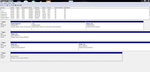

Mike, just to see, I did the same commands on one of my SSDs. I copied and pasted the commands I wrote for you, this is what it looked like except I was using a different disk number. This is what I got
This is disk management when I finished. It's the last disk.

When you typed clean, it should have deleted all partitions on the drive.

I went as far as I could without doing it again ?
It only offered so much :/

That's OK you can always borrow more if you need it using the boot disk. Some files cannot move in the Windows edition since the OS is running.
What's really cool is it can give/take space to/from non-adjacent partitions, too.
