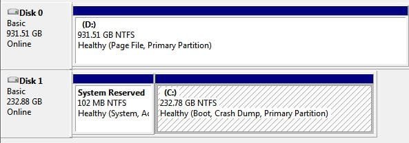

I'm not sure from which drive it is booting. I can say that it did boot much faster than it did before the install, which--to me--would indicate it's booting from the SSD. I have placed an attachment of my disk management. It says that the SSD is the boot drive.

I didn't do a full clone, I just moved the C partition to the SSD. I already have the drive setup with the os/programs on the C drive, and my files and user folder on the D drive.

Thanks for getting back. Yes, it seems that the SSD is the boot drive, so all seems to be well.

I notice that the pagefile is in D:\ drive.
This may slow down your system, and may cause error.
You need to reset the pagefile back to C:\ drive.
In case the D:\ drive may act funny, which may cause your system also funny.
Once your put back the pagefile to C:\ drive, then the D:\ will have "Primary Partition", will do.
It is best to let the pagefile stay at C:\ drive.
After completed, you need to restart and check the location of the pagefile, as confirmation.

Eric, why do you think that the page file on D may cause an error?
Page file is virtual memory and can be on any drive. With a lot of memory (8G) the system probably won't need to use the virtual memory.
I myself have 8G of memory and my page file is on D drive, fixed value (min=Max=16G). Been using this configurations for more than 4 years without any problem.

I'm so glad you noticed this. I was actually following step 33 in this guide.
