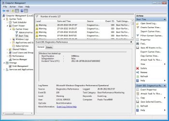

good news :-) (last reply was from another computer!).
Yestarday at 19:25 before shut down battery power was at 46%. Today at 9:25 power was at 45% !
So 1% in 14 hours (and the shut down and power on may drain some W too) gives you 0.071% / hour which is 6.2 x less that the previous numbers (7% / 16 hours!).
Only think I did was to disable USB sleep and charge!!!! So we can say that even without any device plugged in, the USB sleep and charge drains a lot of energy from the battery! Nice :-)
Let's see what other stuff could drain power too! I will report it here if I find others!
And, maybe nothing to do with it...first time I drop the 20 sec for complete boot :-)
Cheers,
paulo
