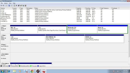

I detached my laptop HDD and tried to use it as an external HDD so that i can backup any data i can access before doing any operation on it. I can access my E:/ and F:/ drives but can't access C:/. Also, whenever i connect my HDD to another, it asks me to format my C:/. I checked my HDD in the disk management and C:/ is marked as active but its type is defined as RAW. Also when i had tried to explore my C:/ drive, the system popped up a dialog box saying that the volume does not contain a recognized file system. Please make sure all the drivers are loaded and the volume is not corrupted.
Attached is the disk management snapshot. G:, K: and L: are my C:, E: and F: drives respectively
