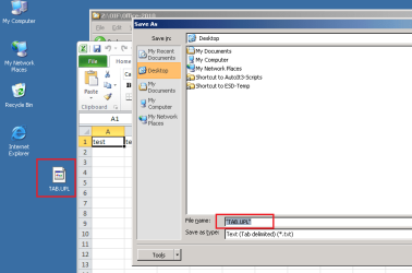

Here's Excel running in an XP Virtual machine -- From what I see the EXCEL program appends the file type depending on values entered from the drop down on file type. I don't see any change in W7 to the way it was working in XP.
Cheers
jimbo

Here is Office 2010 on XP:
