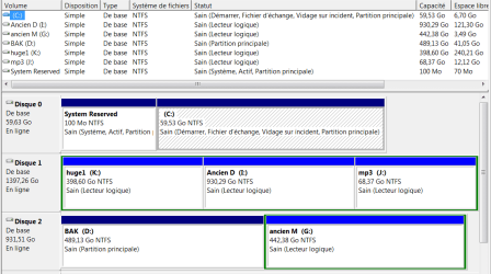

Please post back a screenshot of your maximized Disk Management drive map and listings:
1. Type Disk Management in Start Search box.
2. Open Disk Mgmt. window and maximize it.
3. Type Snipping Tool in Start Search box.
4. Open Snipping Tool, choose Rectangular Snip, draw a box around full map and all listings.
5, Save Snip, attach using paper clip in Reply Box.
Tell us what is on each partition.
What frequently causes the problem you describe is bad boot code interfering from the problem HD. To try to resolve this move the data off of it using a rescue disk if necessary, then test the HD with all others unplugged by booting into Data Lifeguard Diagnostic for DOS (CD) to run an Extended scan, followed by Quick wiping the HD of possibly problematic boot code. Copy & Paste - in Windows Recovery Console
Paragon rescue disk to recover data
Then boot into Win7 with HD connected to repartition in Disk Mgmt. If it still causes problems check the cabling.http://support.wdc.com/product/download.asp?groupid=605&sid=30&lang=en
It's good that I had a screenshot ready, made one month ago, then, it will display what it was with my problematic disk, then, here's your screenshot Greg, thanks for your answer :)
Basically, only the 60GB SSD disk contains system files, the rest is storage stuff, videos, isos, image collections, and more backups.
The "c:\program files (x86)\games\" folders were installed in the now missing disk, with a "mklink/j" command, apart from that, there's nothing fancy. I tested, removing this symbolic link and creating a new one to point to an existing partition, it didn't change anything.
