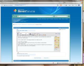

I have a glitch that I am hoping someone can help me with.
I auto hide my taskbar
I have a window that I size from the top of my window to the bottom.
I use "switch user"
When I return to my user the window size has reduced in height from the bottom of the screen the width of an un hid taskbar.
the attached pic is showing the monitor from top to bottom. As one can see the window is not full height but shortened the size of the taskbar.
Sorry if this is an exsisting thread.

I don't know that it would help, but try setting it to run in a maximized window in the program's properties. That would work when initially opening it, but I'm not so sure about in the situation that you describe.

This is a known bug (I mean feature of Vista/Windows 7). In the days of Windows XP almost no software knew the "start bar" was there so the applications would cover it. It frustrated many people that use Auto Hide. Starting with Windows Vista the OS now remembers that the "start bar” location and forces the applications to stay away. One small problem Microsoft forgot to update the OS when the "Auto Hide" is in use. Most likely programming the code to remember the location was easier then programming code to monitor the "start bars" location and status. If the "start bar" is to spring open then your application/window would have to move up, when the "start bar" hides then your application/window would need to move down. So it is just easier to remember where the "start bar" is and not care if it is hidden or not, and force the application/windows to not use the space the “start bar” is or can be using.

is the account you are switching to using hidden taskbar also?

Yes the I tried an account with auto hide and one without.
I think as windowstar indicates it is a code issue. It looks like when one swites back to ones user it loads the taskbar, then reloads the window graphics THEN rehides the taskbar. This leaves the gap... another glitch that makes useraccoun fast switching usless/annoying. Much like the fact that aliging icons to a grid gets all screwed up when fast swtiching.
