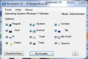

Reenable II Lite didn't solve the problem. Thanx for trying to help, anyway... :)
