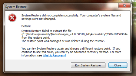

Hi Saurabh A, thank you for replying. I have followed the instructions in your first paragraph. System restore worked right through to the end, leaving a message, which I have attached.
I then followed the instructions in the last paragraph, and the diagnostics reported all OK.
I then rebooted into 'normal' set up, and the system restore message was there saying it had not completed successfully, so I started it again. Sadly, the same problem persists where by it 'hangs' on initializing.

Hi SheilaB,
Hope that you attempted 'System Restore' using a different 'restore point'. The 'Restore Point' that you used previously may not have been 'healthy'; therefore did not lead to restore completion. If you are unsure about it, you may attempt 'System Restore' again using another 'Restore Point'.

Hi SheilaB,
The available 'System Restore' point may be damaged or corrupt, due to which 'Restore' is not completing. Please share if you are still facing any other issues with the notebook. You mentioned in the original post that 'Scandisk & SFC scan results' look normal.
If you'e not facing any trouble at the moment, you may want to create a new 'System Restore Point' at this time: http://www.sevenforums.com/tutorials/697-system-restore-point-create.html
A newly created 'Restore point' is likely to be healthy and should facilitate a successful restore, if needed in future.
