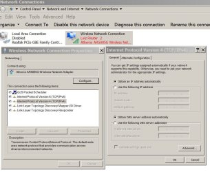

Have a look at the Control Panel\Network and Internet\Network Connections - Wireless - properties.
