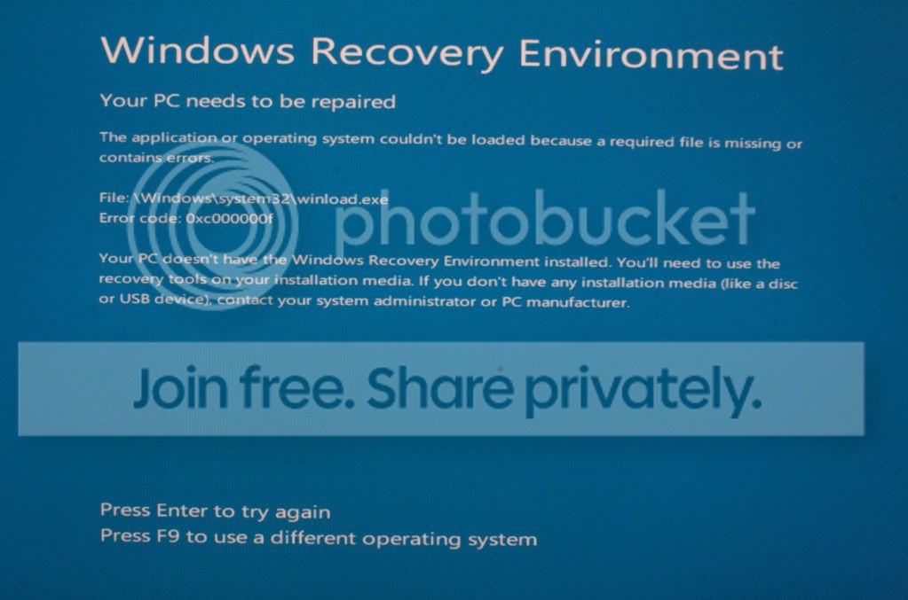

I is now easier to get into Win 7, I just get this screen during boot up saying that it looked for win8 and couldn't find it and press F9 to boot to Win 7.

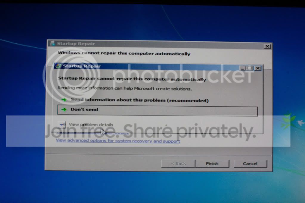

I have tried running Win 7 startup repair and this failed to fix it.

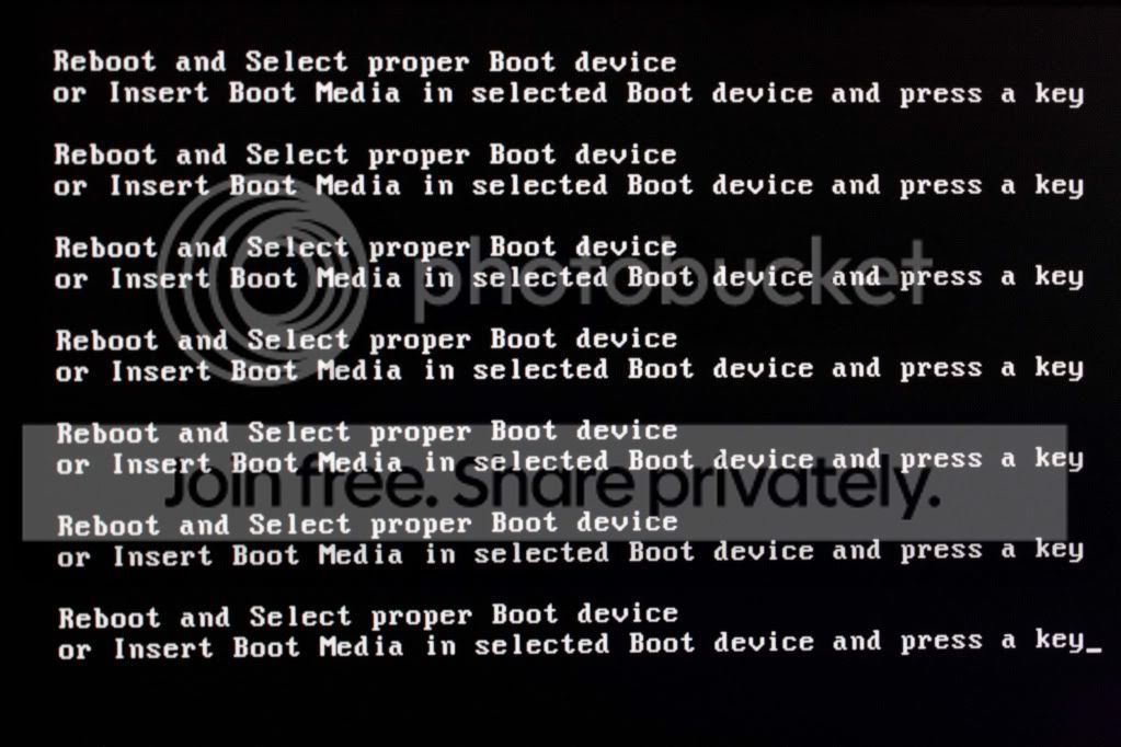

I have also tried disabling all other boot devices leaving just 'Removable Device' as a boot option and I got this screen..
I tried plugging the usb in different ports and pressing a key to try again with no luck.
What should I try in order to get my machine to boot from usb?

@AddRAM On my motherboard I don't believe there is a difference between priorty and sequence, in fact the list is called 'Boot Priority Sequence' and yes 'Removable Dev' was No 1.
I still wasn't managing to boot from USB then I realised I could press F8 at startup to choose what to boot from.

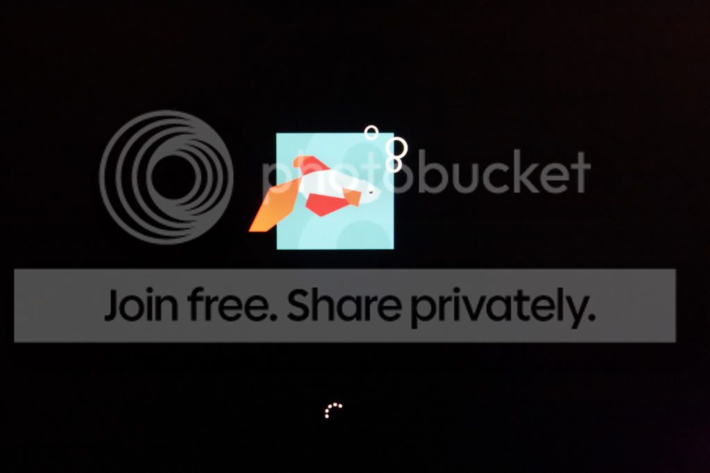

It starts to boot, I get this screen with the dots going around in a circle..
Then the screen just goes blank. I try it a few more times and the same happens. Then I start getting an error screen. I boot up the Win 8 setup again and go into the advance settings and try to repair the startup but it says it couldn't fix it.
What do I do, is there a way I can fix this? Is there a similar known problem with previous windows versions?
Or do I just have to format the partition again and remove Win 8 from msconfig>boot again?

But for this type of failure during Win7 install I would enter Device Manager during install to uninstall any Devices in error - most often Display driver - to see if installation will complete and then update driver from Desktop. Device Manager - Access During Windows 7 Installation
If this fails I would confirm the ISO integrity, burn another using ImgBurn at 4x speed or write to flash stick using Universal USB Installer with Win7 in dropdown. Delete and reformat the target partition during booted install.

I followed the instructions in the link you gave. I disabled the graphics card. Win 8 finished installing. I discovered NVidia had recently released new drivers for my 8600 GT that covered Win 8 so I installed them.
Then I thought it was failing to boot again. Which was not the case, instead after the post screen had been displayed Win 8 was switching to displaying on my TV which is hooked up to the HDMI out on my graphics card. So I entered Win 8 and set it to display on my second screen only.

This may be a setting in your BIOS or on the card.
Having video outputted to a projector or TV is the occasional cause of the screen going black during install, although we haven't seen it too much lately so it didn't ring a bell.
