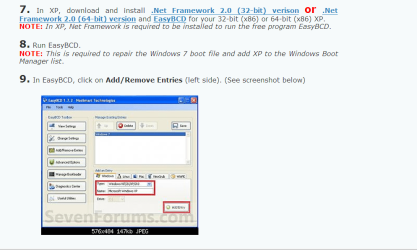

However trying to use EasyBCD to configure it so I can choose either Windows 7 or XP at startup (so I can carry on with the XP setup) and it just won't work.
I go through all of the steps and it appears to put the second entry into the BCD, pointing at S: where I can see ntldr and co are. However when I reboot it goes straight into Windows 7 and when I run EasyBCD the second entry has disappeared. Done this three times so far with the same result each time.
Can anyone tell me why EasyBCD does not seem to be saving the settings I give it?

You need to use EasyBCD 2.0 beta after doing quick registration in their forum to use beta.
It is automated to account for the Win7 System Reserved partition.
You may need to Remove any attempted XP entry first, then Add it back, accept offered boot files, let it autocomplete, Save, Restart.

I gave EasyBCD 2.0 a go and it has worked - thanks. For anyone else having the same problem, I added the entry in EasyBCD 2.0 in a similar way to the instructions in the guide, and with reference to GregRocker's post above - I didn't choose to re-install the bootloader afterwards and it went through fine.
Saltgrass -it was after the first reboot during XP setup that it then refused to boot into anything at all (as the guide suggests might happen). I did have a system reserve partition in Windows 7 but it didn't have a drive letter. Once I had run the various fixes for the mbr and bcd from the windows DVD I was able to boot to Windows 7 fine and then run EasyBCD from there. 1.7.2 didn't work for me though, but 2.0 beta did :D
Might be an idea to update the guide to tell people to use version 2.0 when running in Windows 7?
