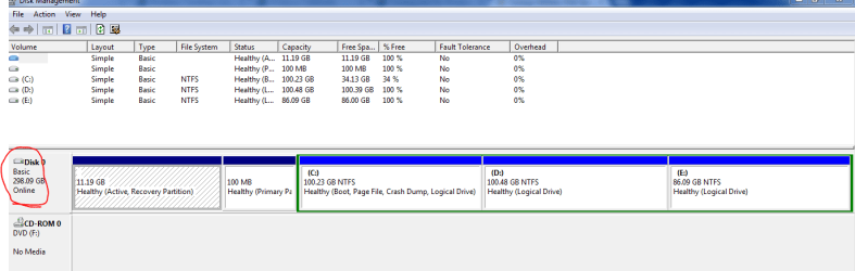

I mean to say that almost 40GB of space is not shown in the disk management after using this.
I have a total of 320GB hard disk but its showing total size of ~290GB only! Where did the rest of space go? Please tell me how to restore it!

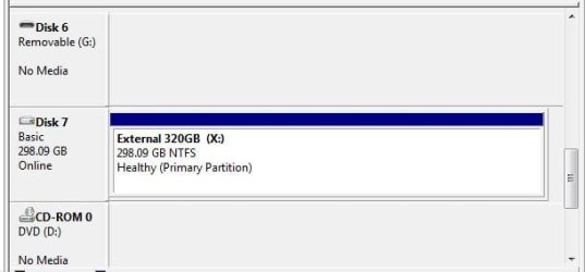

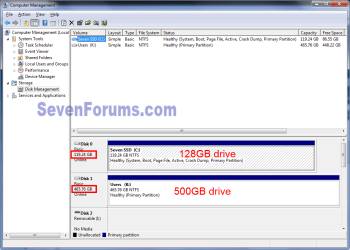

Ahh, OK. 298GB is about the correct size to be shown in Windows for a drive. The difference is due to drive manufacturers selling space in decimal size and Windows using binary mode to calculate size. You haven't lost any thing.
Here is my disk management showing how a 128GB and 500GB drives are listed by Windows.
As an experiment I attached my 320GB drive and it shows the same as yours in w7.

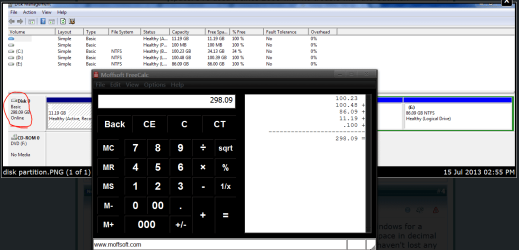

If you see my attached image, and if you see it closely you will find that the total size of all the disks is NOT EQUAL to 298.09GB (which it should according to you) ?
And what does the "Delete free allocated Space" means then ?

It adds up for me.

SORRY!!! MY BAD!!!!!!! :rolleyes:
