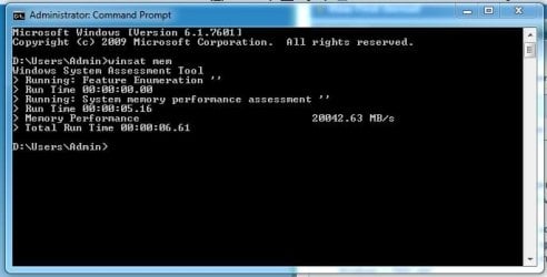

Here's my Winsat Mem score:
Not much to write home about compared to some of the other rig's scores that I've seen.
