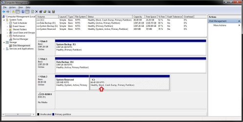

thanks for the answer...
when u mean "boot drive" u mean to the original drive that belongs to the machine, or u meant to the additional drive i added ? because on the both drives i've installed OS
thanks
7
The boot drive will be the drive that the first OS was installed onto and marked as the "Boot" drive in Disk Management (diskmgmt.msc).
Ok, thanks...
and if i unplugged the non boot drive, as you said, the second OS still will present, how it can be deleted ?
thanks again
7
The best way to boot OS's with multiple HD's is via the BIOS one-time Boot Menu key given on first bootup screen or in your Manual. This keeps the HD's independent to come and go as you please, whereas a Windows-created Multi-boot interlocks them.
Of course you need to keep the other OS HD unplugged during install to set this up in the first place, or recover the System Active MBR into a HD which is missing it to make it standalone before BIOS booting will work right.
