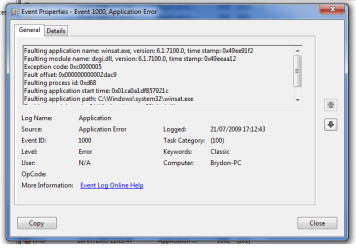

and a screenshot of the windows event viewer. If there is any other information required I'll post it.
