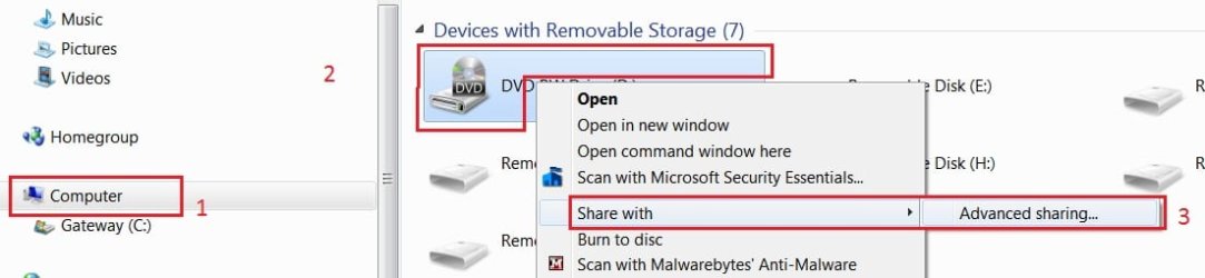

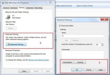

Have you tried going to Windows Explorer on your desktop machine, and left click on Computer (1), then right click on your DVD icon (2) Share with and click on Advanced sharing (3).
Once there click on Advanced Sharing (4) from there you should be able to set your permissions, Apply and OK your way out (5).
This is win 7 I'm hoping your vista is similar.

Okay....But.
Did you check to make sure the Folder (D: drive) or whatever drive your DVD is designated has been set (checked) to be shared as I show above step #5 in the Advanced Sharing dialog box?

@EvilEmpire
Would you post some screen shots of your share like Anak did? Please include the Permissions.
