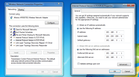

Goto to your network adapter.
windows key + r together.
type ncpa.plc
select the properties of your network adapter and set the following IP address
IP address = 192.168.0.x (number between 2 and 254)
subnet mask should be set automatically
Default gateway/DNS will be the IP of you router
To determine this try typing 192.168.0.1 into your browser to see if you can connect.
i tried this but it didnt work either :(
EDIT: after i set the static ip and i use opendns's dns server, the network is indentified, but i am still not getting any internet connection :(
