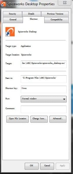

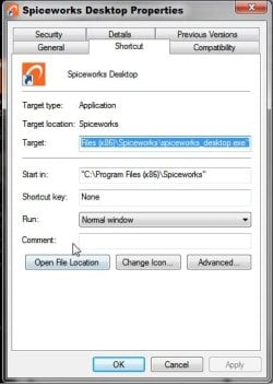

I uninstalled myVapors software and now my fonts are messed up and it appears as if the resolution in certain windows is off as well.
I have attached examples.
I've tried resetting fonts in control panel>fonts. I tried setting my theme back to default windows aero. I tried changing monitor resolution. sfc /scannow found and fixed corrupt files but had no affect on my issue. I deleted font cache with ccleaner to no avail. I reinstalled myVapors and nothing changed. I'm running out of ideas.
Any thoughts?

Turns out it was because I had my dual screens set up in a mosaic format. I disabled that and rebooted, and everything was back to normal.
