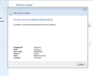

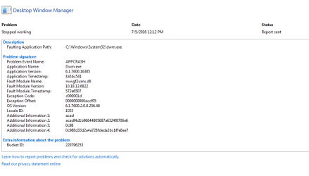

For some reason when I login to my computer I get an error of Desktop Windows Manager stopped working.
Capture1.PNG. After that I try to run WindowsUpdateDiagnostic.diagcab but get Capture2.PNG an get an error. Not sure what to do. Maybe someone can see the files and maybe its an driver issue.
