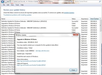

Hallo all.
I`m using Dell Inspiron N7010 with OEM Windows 7, 64 bit. When I tray to upgrade it to win 10 it gives me this error code, please see added jpg. All other update work fine.
I add update error jpg, and CBS file.
Can someone help me please!
Hi.
Can someone help me please with this problem. I tray to use also fix tool but don`t help me :( .

BitDefender appears to be causing a lot of problems in the registry - I would suggest uninstalling it (it's also very likely massively out of date!)
A number of Dell services are causing problems - you should uninstall any you are not actively using.
Once you've uninstalled BitDefender, run their cleanup tool - http://www.bitdefender.co.uk/support/how-to-uninstall-bitdefender-333.html then install MSE at least on a temporary basis.

Hi, there.
Big thank you for help, antivirus do this problem, when uninstall it got WIN10.
