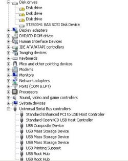

USB Probs
I think it happened during a 'critical update' or removal of Acronis 11 not sure but just today or so..at first I had a problem with Microsoft essential did not update correctly..and had to remove it..Microsoft helped me..but removed many many permissions seemingly. When it rebooted I saw the effects no USB disk drives recognized by win 7x64. I have many screen capture shot of each sort of error..I found out the my USB Device is corrupt that is the drivers when I uninstalled and then installed via reboot same thing I get a yellow triangle in Devicedriver not fixed USB Capture.JPG
usb device failed Capture.JPG manger...storage I have 3 drives all saying same thing.. I think permissions has been taken away or something like that..

I don't see the Device Manager screenshot, the most important one.
We need the Driver tab from each device in error as well.
Meanwhile try installing the drivers from an Admin account.

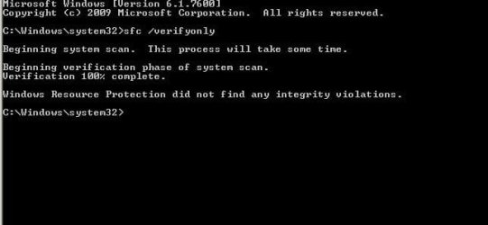

You may have messed up the registry with the attempted reg merge which is more advanced than any normal user should try. Run SFC -SCANNOW Command if necessary from DVD Repair console or Repair CD command prompt so it doesn't depend on possibly corrupt System Files: SFC -SCANNOW Run in Command Prompt at Boot
If this fails, consider a Repair Install

Take a screenshot of the Device Manager with any devices in error expanded so we can see their listings.
Use Snipping Tool in Start Menu, attach using paper clip in reply box.
Then click on the erroring Devices to take a screenshot of the Properties box with Driver tab showing for each.
If you have Problems running System File Checker, boot the DVD or Repair CD, press Shift + F10 to open a Command Prompt, then run SFC command as shown in tutorial linked in blue.
I have run sfc many times but not from safe mode....as well as a start up repair type from repair disk hoping that it might pick up the original sys file or inf files.....no change.

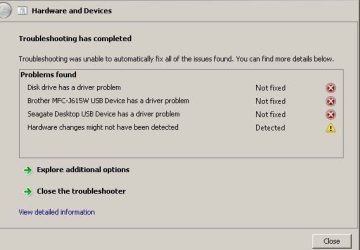

Still not sure what is mean but when I click on the yellow triangle I get properties etc..will show that but it say cannot load mass storage so I will snapshot one the other are identical..The driver detail indicate error code 39...on Google searching I found 1000;s reference but no solutions
When I go down to USB sections they are all working but I updated every one..but did not uninstall as I was not sure where I would get replacements..when expanded they all reported they said they were working OK I show a shot of Standard Bus controller all others were same working
I also show my attempt at updating windows windows defender and the service pack..

If you don't have more than the one SCSCI HD then those disk devices missing drivers are likely card readers built into your machine which needdrivers from computer maker's Support Downloads webpage for your model.

Those devices are USB drives..seems they are all called the same thing.... printer is working fine
SFC integrity check..done full SFC many times..nothing..

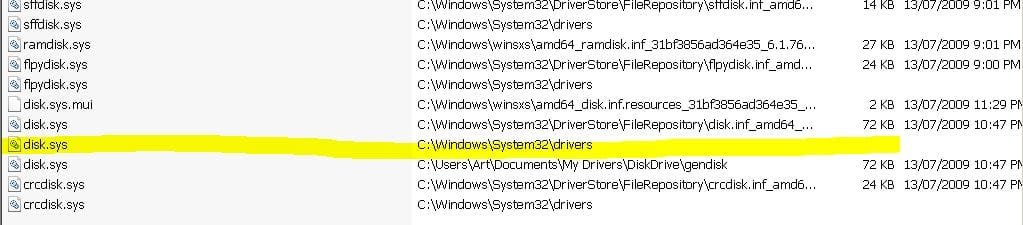

Thank you all who have helped...I ran autoruns and found that the file disk.sys is reported as not found..yet when I look at the device manager installed drivers and uninstall and re-install I see disk.sys as one of the requirements. When I go to system.32 and look for disk.sys I see it. When I search for it and click on the drivers version (see attachments) of disk.sys nothing happens at all..like its not there..nothing on right click etc. All my Drives except internal one need this file to run..If it is corrupt how can I replace it..If say a permissions is stopping a replacement can this cause the problem?
