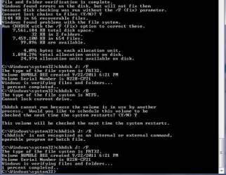

Kaktussoft,i did command prompt and it says:
Volume in drive C has no label
file not Found.
What does that mean?i did chkdisk by CMD and dat command shows that.i have all my files but can not do anything with them.

If chkdsk /R does not run to completion or help you, the only thing I can think of is something like Recuva or GetDataBack. I don't know if those 2 applications work on USB drives.
Otherwise, you may need a professional data recovery service and that would cost hundreds of dollars.
