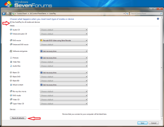

In the control panel go to "Program Access and Defaults" then select "Change Autoplay Settings"
Then if your device is not listed, try the marked options.
If the device is a drive and has an autorun.ini file, open the .ini and see what file it points to and report back.
I set them all to defaults I noticed that my old windows phone is at the bottom as well as my new Samsung. Still getting the error after setting to defaults and I don't see any Autoplay for a usb

I fixed it by plugging the USB in and then went to Autoplay options and chose ask me everytime for some reason dropbox was set as default even when I chose to reset it all to default. Thanks guys
