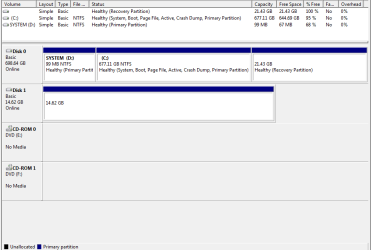

It does't show in the computer window. Here is the screenshot:

My USB flash drive is 16gb, can it be the "Disk 1 14.62GB"?

Try right clicking on it and asign a drive letter.
on motherboard
6 pata Ide HD's & 2 Sata HD's
All Generic Full Towers
Fast Cable InterNet
Linked via TeamViewer !
It tells me:
The operation failed to complete because the Disk Management console view is not up-to-date. Refresh the view by using the refresh task. If the problem persists close the Disk Management, then restart Disk Management or restart the computer.
I used the refresh task, then Disk management crashed, I restart it, and I get the same error message... :cry:

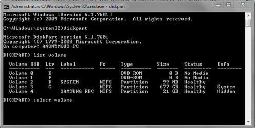

which one is the usb flash drive?

Type list disk and press Enter to see if it may show the USB. Look at the size to help ID it.
If so, then use select disk # , then type list volume.
In addition, you might see if you may be able to use an option in the tutorial below to recover the USB.
Partition - Recover Deleted Partitions in Windows
Size: 14 GB / Free 0 B
None of the 5 volumes fits that.
