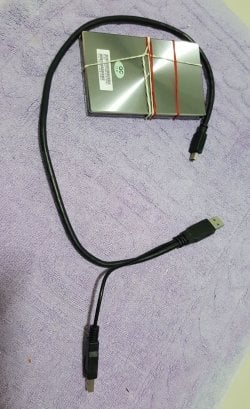

To add on to what is mentioned by RolandJS
If you are using 2.5" external box without external power adapter supply.
Do find a 3 point cable, that is, the USB connect to device, another direction into the USB, Plus 1 point to USB for power.
In other words, this external devices need the power from the computer, beside the data.
One end to the external box, as shown, and the other to 2 USB ports.
The center point is for data USB, whereas the other point (short) is for additional power required.
Refer to the picture.
Edit: NOTE: This cable come with the external casing.

The cable shown in your photo is the type I have. It came with my NexStar TX 2.5" SATA Hard Drive Enclosure. When my laptop failed, another member suggested I purchase the enclosure so I could use the hard drive externally.
So this means ruled out USB cable.
