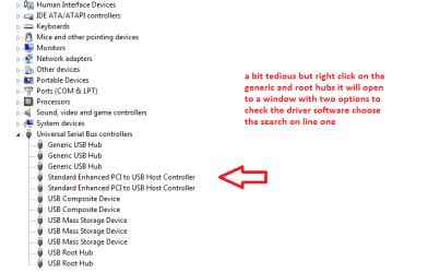

Hello and welcome Matteo mate have you tried updating the drivers for the USB ports see my pic.

Thanks a lot ICit2lol for your suggest, but I have already tried that way and it doesn't work.
Anyway, I have some update.
After further investigation and some attempts, I think that the real issue I'm experiencing is the following:
The system somehow loses the drivers for the USB device (actually only storage devices, mouse and keyboard is working properly), and did not recognize them any more.
In addiction, when I reconnect the device, system fails in installing drivers. The same happens with PC which device has never been connected to (i.e. my colleague one), but not with PC which device is usually connected to (i.e. my two other PC I mentioned before).
Again, thanks for any idea...
