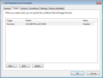

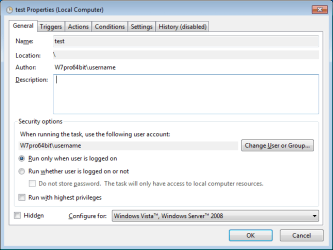

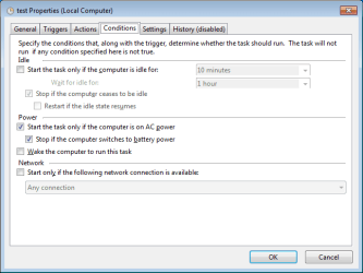

I've followed this thread since the first day that you posted it. I've tried/failed several times to replicate your issue. My 2nd batch file runs just fine no matter if the first file has lost focus or not.
Conditions gleaned from the original post:
1st batch file starts via a scheduled task
1st batch file is left at the pause line while other tasks are performed
(thus the 1st batch file is not in focus for a while)
1st batch file is brought back into focus and "any key" is pressed
I added a ping delay so that I could take the first batch file out of focus again before it called the 2nd batch file... but I got the same results without the ping delay. The 2nd batch file worked every time.
Click on each image to enlarge:
Instead of us attempting to replicate your failure, please see if you can replicate my success using the simple/tiny batch files shown above (along with the simple scheduled task). Then little by little, add complexity to the 2nd batch file and let's see where it starts to fail.
