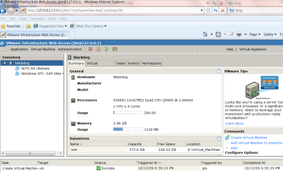

Hi is that on VMWARE server
It shouldn't happen
Can you post a screen shot of the Console when running one VM (the server console not the Virtual machine's console)
Example shown in this shot with one XP vm running and creating a 2nd VM - W7-X-64 ultimate
BTW you should define your Virtual Machines as SINGLE PROCESSOR and split the Virtual disk into 2GB chunks rather than define the whole kybosh in one go.
Exception if your VM is running a database then DO define virtual disk(s) in one go - not in 2GB chunks -- keep single processor and you don't need the same amount of RAM as you would on a real machine - even W7-X64 ultimate will run happily on a 1 or 2GB Virtual machine --running VM's are DIFFERENT to real machines in terms of resources.
Note you'll have to switch VT back on again if you want to run 64 Bit guests under vmware server. You don't need to for 32 bit guests,
