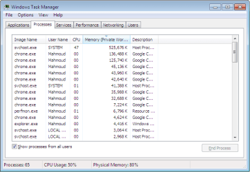

Hi everyone
I have been experiencing some really annoying problem since I switched from XP to Seven on my Dell Vostro 1500 laptop. I had BSODs often, and also VERY high memory and cpu usage by svchost.exe.
I tried to install another windows 7 and I still have the same problems. I also still have the XP, and while it has gotten relatively slow, it works fine, without any of these problems.
I have attached a snapshot of Taskmanager.
Any thoughts?
Thanks

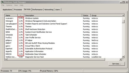

Can't tell what's running under svchost from your screenshot. Add the PID column:
Then check the PID against the svchost instance with the same PID in the services tab.

Hi Callender, and thanks for the reply.
I did that, and the PID was 1048, as you can see in the attached picture.
Cheers
