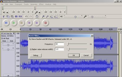

I just opened Audacity and looked at the menu choices under the "effect" menu.
One of the choices is notch filter, so apparently it is built in to Audacity and you don't need a plug-in. At least, I can't recall downloading a separate notch filter.
The filter is adjustable by slider to allow you to set the frequency it will attack.
The second slider adjusts the width of the "notch". Higher values make the notch narrower and would presumably reduce the effect on nearby frequencies.
I can't say how well it works.
There may well be other "Nyquist" plug-ins that can be downloaded and added to Audacity. I know I have downloaded one that acts as a general "tone" filter that can be used to brighten up the treble a bit if desired.
Here is a pic of the notch filter.
