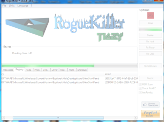

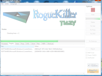

I tried running RogueKiller and it crashed three times. On the 4th attempt it stalled at "Searching". On the crashes it seemed to have found two things.(RogueKillerCrash)
I have windows installed on both C & E. === Edit: I tried running RogueKiller again and it crashed. Managed to get a bit more info about those two objects in pics.(Rogue2/3Crash)
