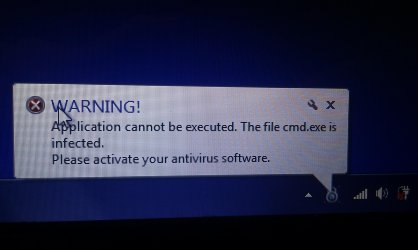

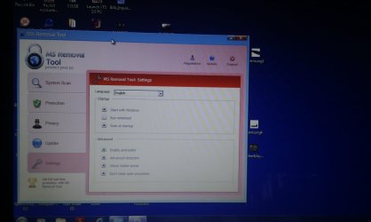

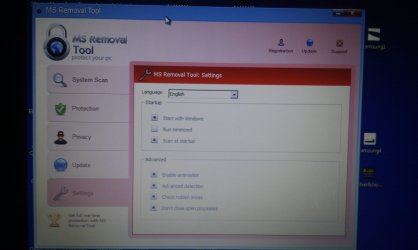

Just today I got an Virus on one of my home computers. It disabled MSE and disallows me from accessing any resources, running programs, or starting the task manager or system tools like cmd.
I can still access Safe Boot mode and ran MSE from safe boot, but the virus/ rouge AV is still on the computer, other than that It turns the desktop a blue color and floods my router with high pings, I can see this from router logs.
Here are some pics, I had to take them with my cell because it disabled the Snipping Tool.
Any help on removing this rouge AV would be much appreciated!

boot in safe mode with networking
http://www.sevenforums.com/tutorials/69585-safe-mode.html
If that keeps it from launching at that point you can download install and allow to update malwarebytes antimalware
Malwarebytes (free version)
Run a full scan and let it do it's thing and clean it out.
That should return you to a position where you can boot normally.
If you can't launch any applications the attached file should return that to normal (all this still needs to be done in safe mode.)

I am able to boot into safe mode and am running a full scan with malwarebytes right now, I will post the log files as soon as it finishes.

I successfully managed to remove the infected files, I have included the log files, I ran a quick scan first and then a full scan.
