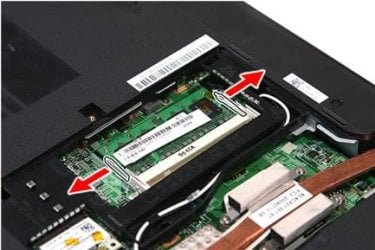

You mentioned about the laptop powering off during the 'Memory Tests'; may point at a possible 'memory failure'. 'Inspiron 1546' laptop has 2 user-accessible memory slots. Both slots are accessible from the bottom of the computer and are 'stacked' on top of each other. You may run 'Memory Diagnostics' again with only 1 memory module at a time to find the card that may be causing trouble; you may try each card in both 'memory slots' (one by one) to isolate if the 'slot itself' is the culprit.
To remove a memory module, you may follow these steps:
Remove the screw securing the module cover > Remove the module cover > Use your fingertips to carefully push the retention brackets away from the top memory module until it pops up > Slide the memory module out of the slot > Remove the memory module (You may want to refer to the following images)
Safety instructions: Disconnect the AC Adapter; Remove the Battery; Remove the Access Panel
Do reply with the findings; would be glad to assist.
