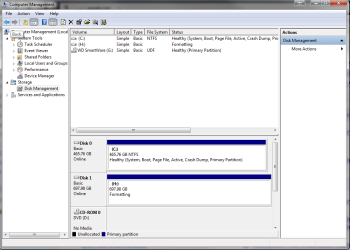

Hello saidas108, welcome to Seven Forums!
Please post a snip/screen-shot of Windows disk management so we can have a look, in the Windows start menu right click computer and click manage, in the left pane of the "Computer Management" window that opens click disk management and post a maximized snip of that.

Hope this is large enough. I couldn't figure out how to make it bigger. I appreciate all of the info and links but am afraid most of its over my head. If you can just give me the easiest way to do what is needed to get the backup working I'll do it! Thanks!!!!!
