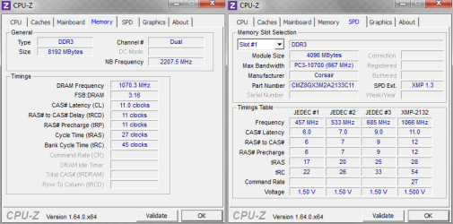

Hey all, I currently have a set of cmz8gx3m2a2133c11r and want to get another set. now iv heard stories about people buying same sets and them not working well together as they were bought at different times. My question is if i get them at newegg vs anywhere else will it matter as they should all be the same timings and i guess if they don't work i could rma them all (all 4 sticks) to corsair and have them made all the same since they are lifetime warranty. I would like them all to just work together from the start though. I have attached what my current setup is.
any input is welcome and appreciated.

my memory is set to xmp so that is not an issue my board will keep it at what i set it too and it is no longer at 2400 its at what my attached pictures show. I am confident if the sticks will work together that I will have fine speeds, im going to getting probably a set of dominators though as 32GB is what I can actually use since I run a lot of VM set ups for work. thank you for the input though, iv been able to get them to 2420 with crap timings but that is not very stable obviously.

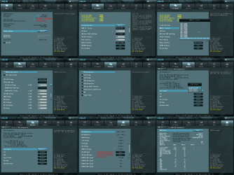

yes so does my motherboard made this guide for a friend. sorry for the size.
