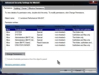

My first suggestion would be to run the System File Checker
If no help, this is often cause by an older BIOS version, check to see if your ASUS has a newer version for your MB.
Also, this can be a permissions issue. You can try taking ownership of the C:\windows\Performance\WinSAT folder. Also, check the permissions:
Navigate to C:\windows\Performance\WinSAT
Right click on folder and choose properties
On Security tab, click on the advanced tab, and see if your permissions look like mine
