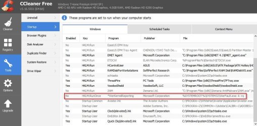

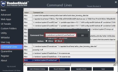

I keep Windows Error Reporting service disabled on my home based machine. As far as I can work out (I'm not expert on this) if an application crashes an error report is generated (even though it's not sent) and blocking the command line prevents the report from being created. I don't need those reports.
Also see: Windows Error Reporting - Disable in Windows

As I noted in the post title - I have Windows Error Reporting disabled (just as you have in CCleaner) but the errors persist nevertheless. If I close the error reporting pop-up, it immediately respawns and the only way to stop it is to reboot. If I drag the pop-up to a corner and continue working additional errors continue to spawn in Task Manager until all (eventually) resources are consumed and the machine freezes.

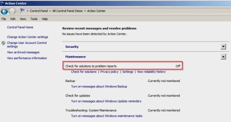

Also what is the browser used and have you tried the following?
Run the browser with add ons disabled.
Check for updates for browser and plugins.
Control Panel> Action Center> Maintenance
