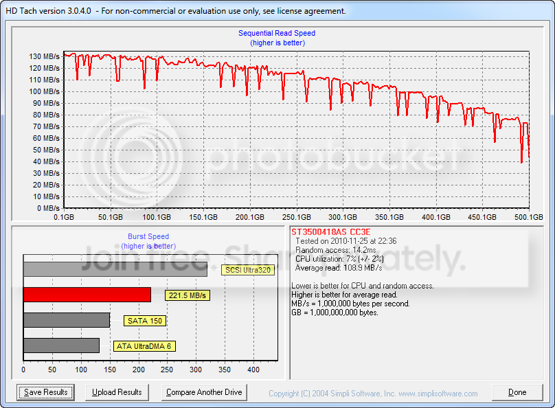

Some use HD Tune HD Tune website
Measures transfer rate (min, max and avg), access time, and burst rate.
Some use HD Speed HD_Speed - www.SteelBytes.com
Measures sustained and burst rates.
Some HD Tach HdTach
Measures read speed and burst rate.
I get drastically different results using each one. These tools just simulate and measure access times mostly I believe, they are not real world speed if you use other techniques like below...
Some apps will show you an average when finished as does Macrium Reflect backup imaging app.
Some, like myself, just copy a large file and measure how long it takes then resort to math! LOL! Or you can cheat and use the Transfer Time Calculator... http://www.pmarks.net/homepage/?page=programs&platform=windows&program=ttcalc
If anyone has other suggestions on tools to measure HDD transfer speeds, etc. please post them here!

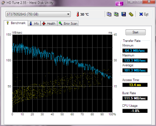

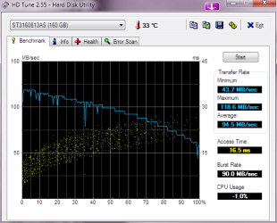

Seagate 750GB Vertical storage and an older 160GB Seagate drive benched with HDTune.
There are settings for various KB block sizes within this utility that change the results dramatically.
I have HDTune currently set to 64KB:

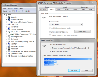

For a quick and simple test (if you have a Nvidia chip set) you can go to device manager. Right click on your Serial ATA Controller and go to properties. Then select a port. Once there, there should be a "Speed test" button. AHCI mode I believe

that's interesting - i don't get anything like that on my system - no port tabs.
maybe it's a feature of your nforce chipset driver?

looks like it is an nforce specific thing - my netbook has it (and a slow drive!)

My daughters netbook doesn't have it. Hers has an Intel chip set so I would say that it is an Nforce specific option. Your netbook drive is likely a 5400 RPM drive and that will hurt performance compared to a 7200 RPM drive.

For a quick and simple test you can go to device manager. Right click on your Serial ATA Controller and go to properties. Then select a port. Once there, there should be a "Speed test" button.
I believe it is unique to Nvidia chipsetted mobo's. I have 3 Win7 PCs and none gets this option, but none have that chipset make either!
