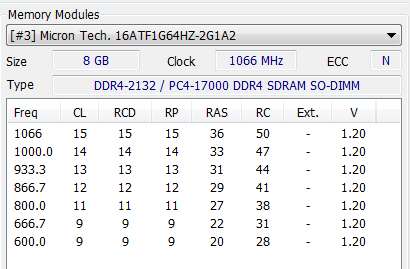

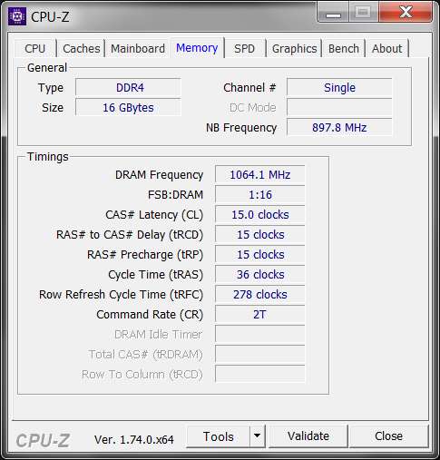

I recently received a brand new Lenovo Thinkpad P70, ordered with the basic 8GB of memory. I also ordered an additional 8GB of memory from Crucial, purportedly compatible with the P70. The P70 has four SODIMM memory sockets and can support up to 4x16GB=64GB total non-ECC DDR4 2133MHz storage with its 6th-generation i7-6700HQ/6820HQ Intel CPUs. It also can come with Xeon E3-1505M processor, which can handle 4x16GB=64GB of ECC memory.
I installed the 8GB of Crucial memory into one of the three remaining available memory sockets, not seeing anything in the documentation that it must be in a specific "paired" slot for best performance. In other words, the Lenovo memory came installed in what was slot #3 (located under the keyboard), with what I'm guessing is actually "paired" adjacent slot #1 next to it (also located under the keyboard). But I installed my additional 8GB of memory in what turned out to be slot #4, in an instantly accessible location on the underside of the laptop gotten to immediately after removing the bottom cover. The second adjacent "paired" (to #4) slot on the underside I assume would have been slot #2.
So I ended up with 8GB of memory in each of [what I believe to be] UN-PAIRED slots #3 and #4.
The net result is performance behavior shown by CPUZ as "single" rather than "dual" as I would have expected and certainly wanted to obtain.
The question is why? Is the issue that I didn't add the second 8GB to the corresponding "paired" slot #1 (which would have required me to remove the keyboard to get to), to go along with the Lenovo 8GB of memory which was delivered in slot #3? Or is the issue that the two memory sticks have slightly different timings and therefore the BIOS rejected them for "dual" operation?

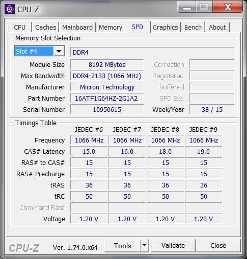

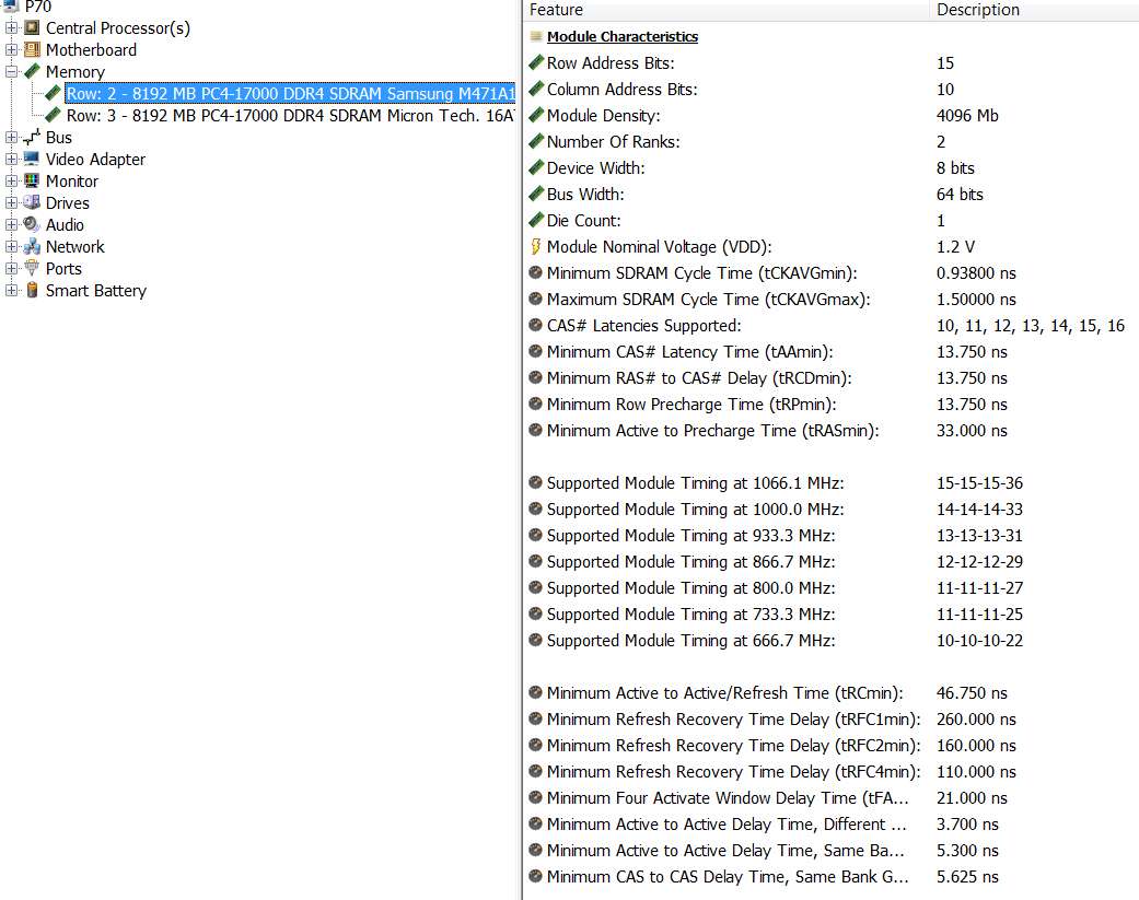

To eliminate any possibility that is the different timing values for the two memory sticks which is at fault, I've gone ahead and ordered a second 8GB of Crucial memory, to match the first 8GB I'd already bought. I plan to replace the 8GB of Samsung memory with this second 8GB of Crucial memory, thus having an identical matched pair.
I also plan to move the Crucial memory currently installed in slot #4 (underside of laptop) to instead by in slot #1 (under the keyboard). And I will replace the Samsung memory currently installed in slot #3 (also underside of laptop) with the second stick of Crucial memory. This will then produce a matched pair of memory sticks with identical timing numbers, in adjacent "paired" slots #1 and #3.
Surely that should produce "dual".
But in the meantime I really do have questions as I've posed above.
(a) Is it the choice of the wrong slot that I installed the second 8GB into which is causing the "single" behavior?
(b) Or is it the somewhat different timing values of the two memory cards which is the culprit?
(c) And for my own knowledge, which of the cards (Samsung or Crucial) is the "faster"? Do lower timing numbers imply faster performance, in which case it seems the Samsung memory is faster? Or do higher timing numbers imply faster performance, in which case it seems the Crucial memory is faster?
Here are the outputs from CPUZ. Notice 16GB total, but running "single". And then there are the timing values for the Samsung (slot #3) and Crucial (slot #4) memory cards.

Ok. I've done some searching to answer my own question. There is a good detailed explanation of these numbers in this article on RAM timings.
And certainly with mostly similar memory sticks (as these are, in that they are both 1.20v and they are both DDR4-2133mhz) the larger the numbers the slower the memory. So it would appear that the Crucial memory is slightly slower than the Samsung memory.
Here are the relevant definitions from that article:
The operations that these numbers indicate are the following: CL-tRCD-tRP-tRAS-CMD. To understand them, bear in mind that the memory is internally organized as a matrix, where the data are stored at the intersection of the lines and columns.
  • CL: CAS Latency. The time it takes between a command having been sent to the memory and when it begins to reply to it. It is the time it takes between the processor asking for some data from the memory and then returning it.
  • tRCD: RAS to CAS Delay. The time it takes between the activation of the line (RAS) and the column (CAS) where the data are stored in the matrix.
  • tRP: RAS Precharge. The time it takes between disabling the access to a line of data and the beginning of the access to another line of data.
  • tRAS: Active to Precharge Delay. How long the memory has to wait until the next access to the memory can be initiated.
  • CMD: Command Rate. The time it takes between the memory chip having been activated and when the first command may be sent to the memory. Sometimes this value is not announced. It usually is T1 (1 clock cycle) or T2 (2 clock cycles).

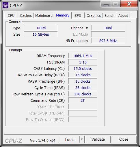

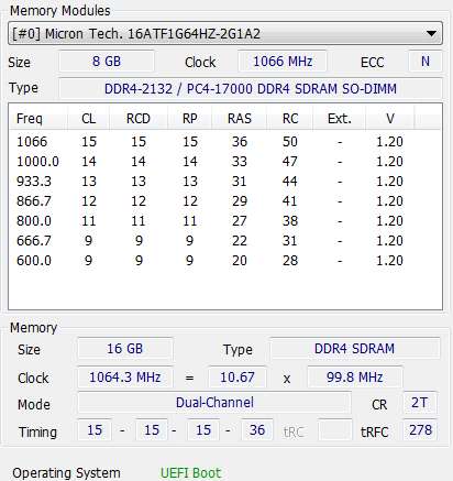

I may not have expressed what I did clearly enough.
I don't have three memory sticks installed. I only installed a single additional 8GB of Crucial memory in slot #4, to go along with the 8GB factory Samsung memory in slot #3. That is what is giving me 16GB running in "single" mode, most likely due to the choice of slots but possibly due to the slight mismatch in timings.
I've used Samsung+Crucial memory in a number of Lenovo M93p desktop machines and it works perfectly in "dual" mode, but in those machine the Crucial memory provided IDENTICAL timing values. Of course in those machines I also used the "paired DIMM slots" as well.
Now, when the second piece of Crucial memory arrives next week I will REPLACE the Samsung memory in slot #3 with the newly arrived Crucial memory. And I will also MOVE the currently installed first piece of Crucial memory (currently in slot #4) into the "matched pair" location slot #1 adjacent to slot #3 (both under the keyboard).
I am not looking for 3x8GB=24GB. I am simply wanting 2x8GB=16GB but running in "dual mode". And I'm sure I will fijnally achieve that using (a) "paired slots" #1 and #3, and (b) identical matching Crucial memory, albeit they are slightly slower than the Samsung memory provided by Lenovo (at what was about triple the price of memory from Crucial if I'd just ordered all 16GB from Lenovo for the P70 in the first place).
This is the first time I've had any problem with Crucial memory not being an EXACT TIMING VALUES MATCH for the existing installed memory in the computer I was upgrading. I will note this in my feedback to them.

More insight into the specific details of the Samsung vs. Crucial memory, this time from HWINFO:
So if I'm reading this correctly, it looks like these ARE essentially identical (certainly at the 1066Mhz that it's running at), except at the lowest frequencies. And even at the lowest frequencies it appears that the Crucial memory is faster, not slower, than the Samsung memory.
Am I not reading this correctly? I wonder why CPUZ reports these numbers very differently for the Crucial memory?
To back up the above charts, here are the memory details from HWINFO.
Again, does this not appear to back up the characterization that the Crucial memory is the same as, if not better than, the Samsung memory?

Ok. The operation was a success. The patient will play the violin again.
Getting to that second memory bay under the keyboard was certainly not an easy surgery, but I have emerged victorious. I removed the Crucial memory from where I had mistakenly installed it originally in the easy-to-access bay on the underside of the laptop, in what was slot #4. I then reinstalled it in the available second slot which was in fact #1 in the under-the-keyboard bay, along with the Samsung memory already installed by Lenovo in slot #3.
And as is shown by HWINFO, the Samsung and Crucial memory cards are truly identical. And now that they are installed in "paired slots (#1 and #3)" the memory is now behaving in dual-mode.
I don't know why CPUZ shows things the way it does when looking at the two cards shown in the SPD tab, but CPUZ also confirms that the memory is behaving in dual-mode.
So as it turns out, the Crucial memory is 100% perfectly compatible with the P70 and the Samsung memory. Also, at 1066Mhz both memory cards operate at the identical speed.
