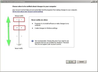

Compare UAC settings
Maybe check UAC settings on each machine. Maybe they're not set up in the same way on each.
I never see those prompts but I'm using something that replaces UAC. Not recommended for most users.
