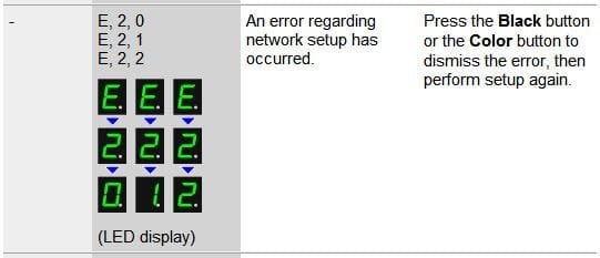

  • Press and hold the WPS button, the dash lines continue to ascend, but after 45seconds I get an error, "E, 2, 1".
I have tried more than a dozen times clearing the error by pressing the "Black or Color" buttons with the same resulting error. Would anyone know what is wrong here?

The manual just says if the network device is already on, turn it off and turn it back on

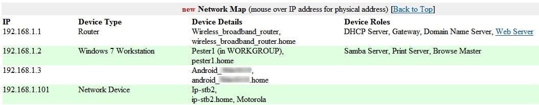

I'm going to have a look into the firewall/wi-fi settings on the Actiontec. Here's my Network Map from Belarc, I wasn't sure, but I blurred out the Android Device details.

I've been looking all over for a detailed description of those error codes like you show, do you have a link to that Manual you used?
